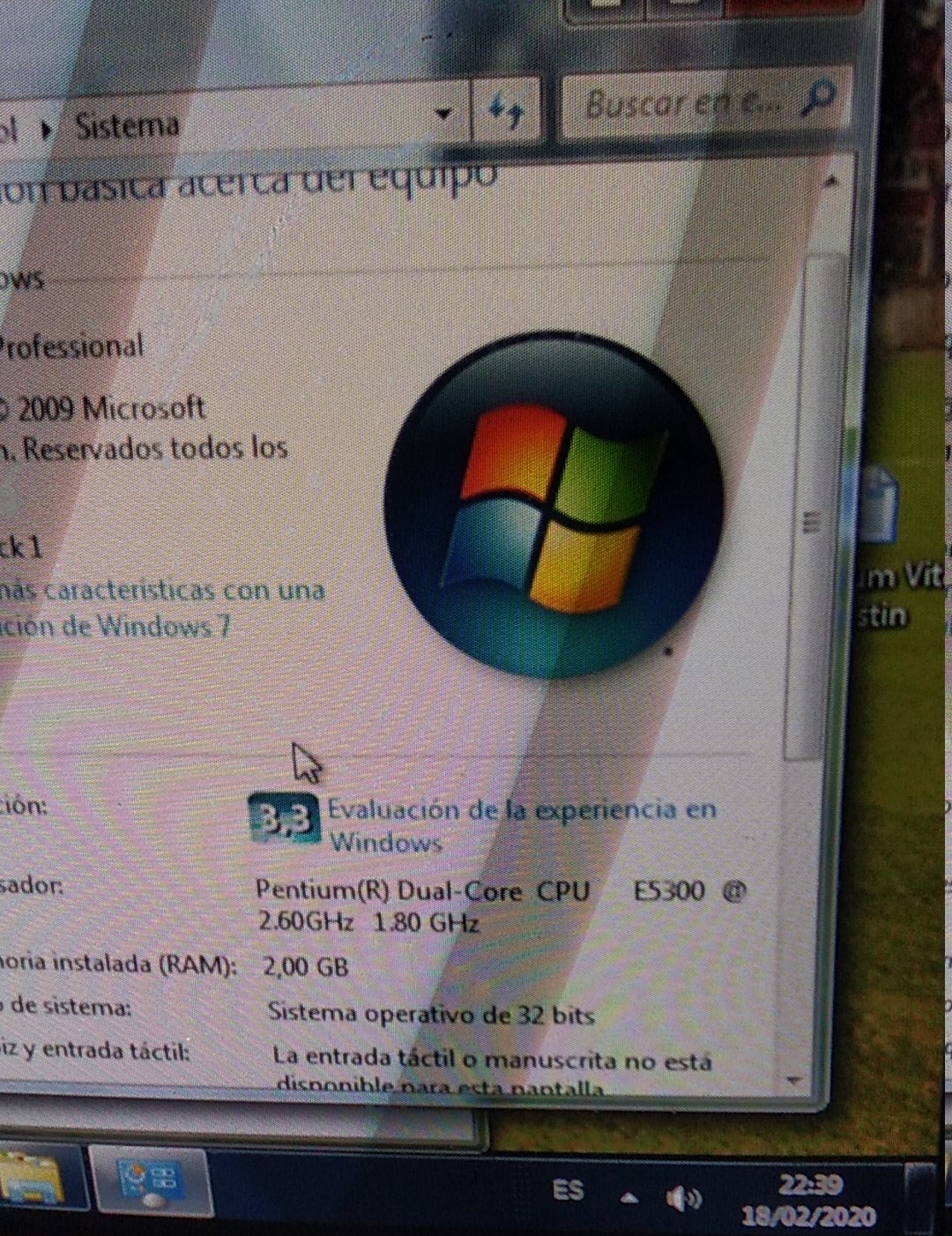

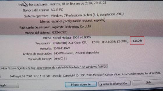

Your processor does not appear in the .txt, it is this:
Limited to 1.8? when should 2.6.

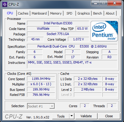

2 gb ram - dual core 2.6, should be enough to run clientmod. Others with the same specifications can do it.
Yes, it didn't occur to me, i thought i would be underclocked. In my AMD processor it is called "Cool'n'Quiet" and I have it disabled.
Would you recommend disabling that feature in the bios? for him
